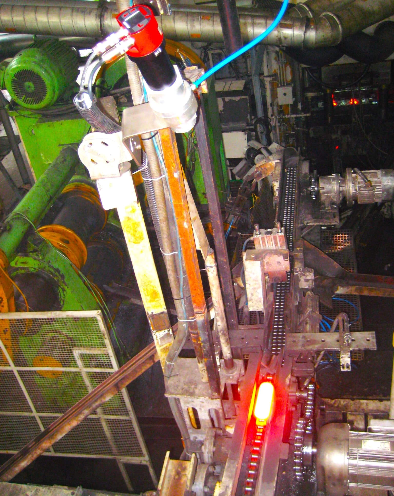

Image Courtesy: Ametek Land
A pyrometer works by detecting this radiation and converting it into an electrical signal, which can then be translated into a temperature reading. The emissivity of the object, its ability to emit infrared energy, also plays a significant role in obtaining accurate measurements.
