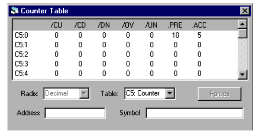

Counter Status Bits

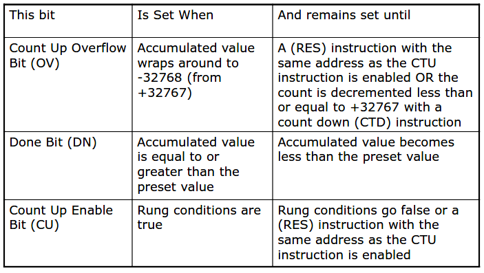

/CU: count up
/CD: count down
/DN: counter done
/OV: counter overflow
/UN: counter underflow
Using Status Bits (CTU)
