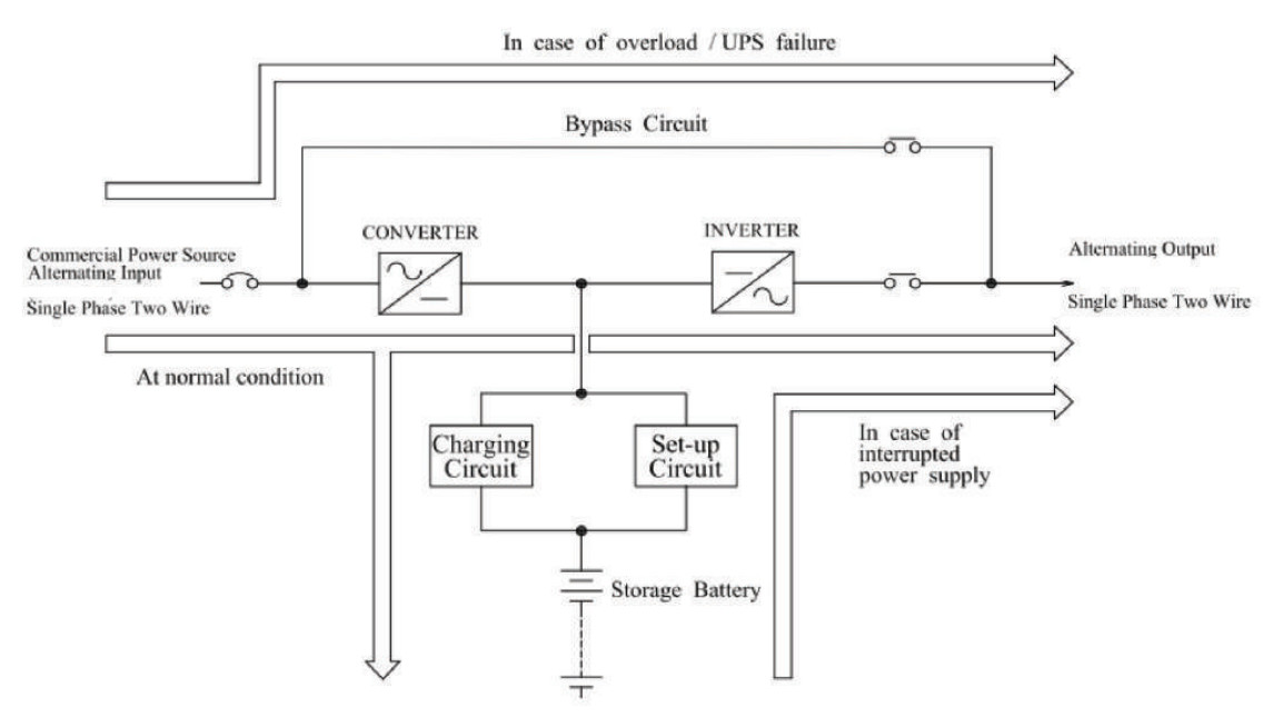

A typical UPS circuit is shown in Figure.
In the normal condition, commercial AC (alternating current) power is sourced and converted to DC (direct current), which is then supplied to an inverter, and charges a battery.
When the commercial power source is interrupted, power charged in the battery is converted to AC and supplied to the load.
The UPS has a rectifier to convert AC supply to DC for charging the battery, a DC to AC inverter to convert the battery output to AC voltage, and a battery to act as a source of power during normal power interruption.
Other components like protection, fuses, indication, surge controlling circuit etc., are also built into the unit.
