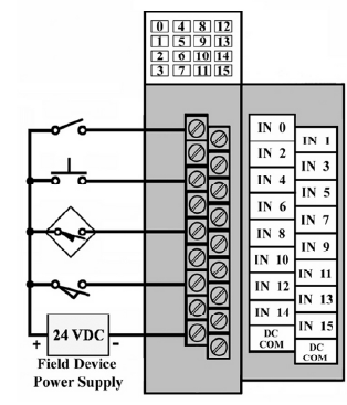

The voltage that would be present between the DC common and terminal 4 with the pushbutton open would be approximately:
A. 0 volts.
B. 6 volts.
C. 12 volts.
D. 24 volts.
Answer: A
