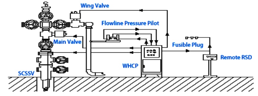

Function of WHCP
- Installation: near the well
- Control the Well: open or close the main shut off valve (SCSSV and SSV)
- By local Push Button on WHCP, activated from ESD, from F&G System or PSD.
- Input: ESD (PSD, PSHH, Fusible Plug) ESD PB.
- Output: Final Control Element, Signal Indicator (Local)
- Equipped with Recorder (Pressure, Temperature and Flow Rate.)
- Reset of the Panel: Manually.
