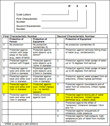

The IP rating is formatted as “IP” followed by two digits. The first digit indicates a protection level against solids such as dust, and the second digit indicates a protection level against liquids. Figure 1 illustrates the IP formats and uses IP56 as an example.
