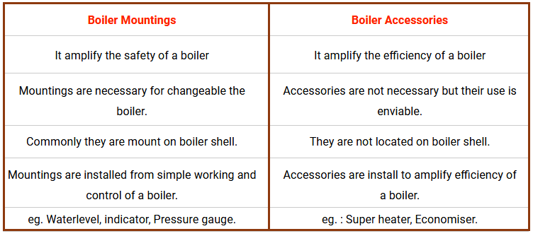

Difference between Boiler Mountings and Accessories

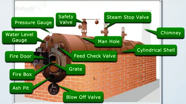

The different boiler mountings and accessories that are installed on the steam boiler are as follows
Boiler mountings
- Water level indicator ( Water level gauge)
- Pressure gauge
- Safety valves
- Stop valve
- Blow off cock (Blow off valve)
- Feed check valve
Boiler accessories
- Air pre-heater
- Super heater
- Economiser
- Feed pump
The function of various boiler mountings and accessories are:
1. Water Level Indicator
- It is fitted in front of the boiler and generally present two in number.
- It is used to indicate the water level inside the boiler. It shows the instantaneous level of water that is present inside the steam boiler which is necessary for its proper working.
2. Pressure gauge
- It is also present in front of the boiler.
- It is used to measure the pressure of the steam inside the boiler.
The pressure gauges generally used are of Bourden type
3. Safety Valves
- Safety valves are attached to the steam boiler chest.
- It is used to prevent explosion due to excessive internal pressure. When the internal pressure inside the boiler exceeds its working pressures than the safety valves blow off the steam and maintains the internal pressure.
Generally two safety valves are present on a boiler.
4. Stop Valve (steam stop valve)
It is usually fitted on the highest part of the boiler with the help of a flange.
The main function of the stop valve is
- To control the flow of steam from the boiler to the main steam pipe.
- To completely shut off the steam supply when required.
5. Blow Off Cock
- It is fitted at the bottom of the boiler drum.
- The functions of blow off cock is
- To empty the boiler whenever required.
- To discharge the scale, mud and sediments which gets collected at the bottom of the boiler.
6. Feed Check Valve
- It is non-return valve and fitted to a screwed spindle to regulate the lift.
- It is fitted to the shell slightly below the normal water level of the boiler. A boiler must have its spindle lifted before the pump is started.
- It regulates the supply of water which is pumped into the boiler by feed pump.
7. Fusible Plug
- It is fitted to the crown plate of the furnace or firebox.
- Its function is to extinguish fire in the furnace when the water level in the boiler falls to an unsafe limit. This avoids the explosion that may takes place because of the overheating of the furnace plate.
