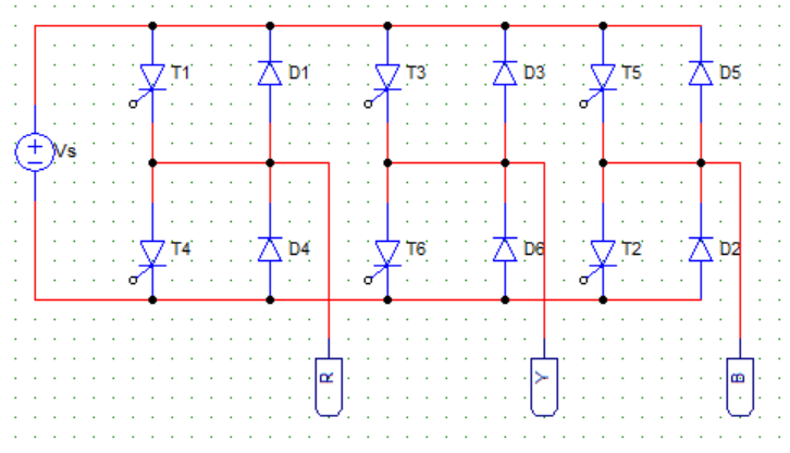

What are the phase voltages when T6, T1 and T2 are conducting?
Consider a star connected R load.
A. VYN = VBN = Vs/3, VRN = 0
B. VYN = VRN = – Vs/3, VBN = 2Vs/3
C. VRN = VBN = – Vs/3, VYN = 2Vs/3
D. VYN = VBN = – Vs/3, VRN = 2Vs/3
Answer: C
