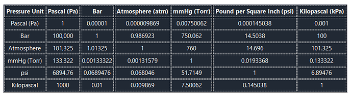

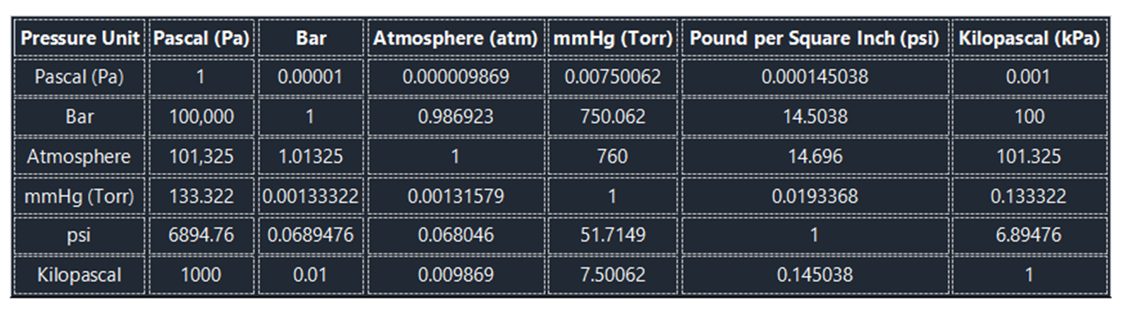

The following is a table for easy and direct conversion between different pressure units.
