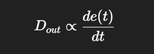

Derivative action responds to the rate of change of error:
Noise contains rapid, high-frequency fluctuations. Since derivative reacts strongly to rapid changes, it amplifies noise, causing:
