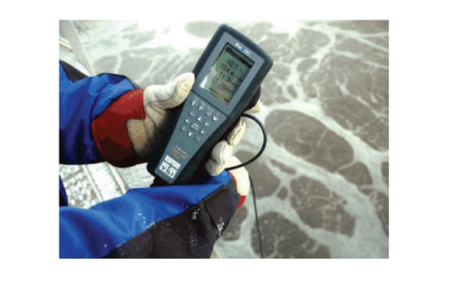

Dissolved Oxygen Meter
A typical hand held DO meter with probe for field use is shown in Figure.
Source: M/S YSI.
