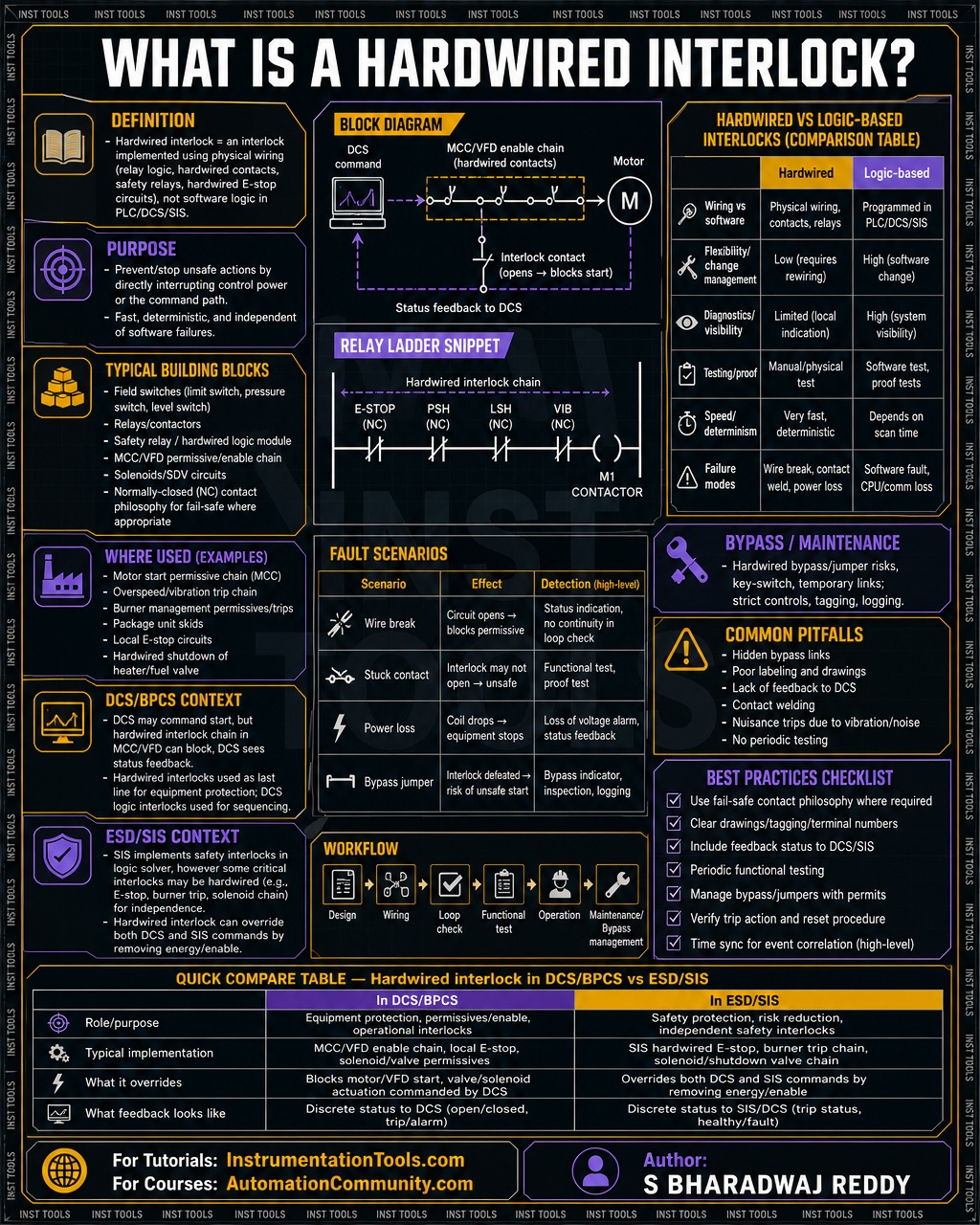

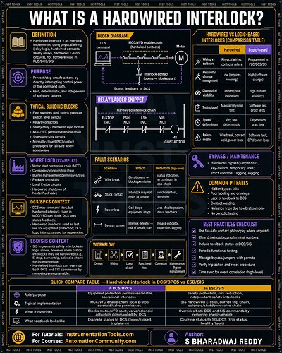

What is a Hardwired Interlock?
:police_car_light::electric_plug: HARDWIRED INTERLOCK: When Safety Depends on Physical Wiring! :gear::factory:
Imagine a motor must never start unless the lubrication system is healthy.
Instead of relying only on PLC/DCS software logic, the permissive can be implemented using physical electrical contacts and wiring.
:backhand_index_pointing_right: This is a Hardwired Interlock.
:small_blue_diamond: What is a Hardwired Interlock?
A hardwired interlock is an interlocking function implemented using physical electrical connections between field devices, relays, contactors, switches, or other control/protection devices, rather than relying solely on software logic in a PLC/DCS.
In simple terms:
:electric_plug: Physical condition β†’ Electrical logic β†’ Equipment action
:factory: Example: Motor Interlock
Suppose a pump motor should start only when:
:white_check_mark: Emergency stop is healthy
:white_check_mark: Lubrication pressure is OK
:white_check_mark: Suction valve is open
:white_check_mark: No motor fault exists
A simplified hardwired arrangement could be:
E-Stop NC Contact
:down_arrow:
Lube Pressure Switch NC/NO Contact
:down_arrow:
Valve Position Contact
:down_arrow:
Motor Starter Control Circuit
If any required condition is not satisfied:
:cross_mark: The control circuit is interrupted.
:right_arrow: Motor cannot start.
:high_voltage: Why Use Hardwired Interlocks?
Hardwired interlocks can provide:
:white_check_mark: Fast response
:white_check_mark: Simple and deterministic operation
:white_check_mark: Independence from software execution
:white_check_mark: Protection against certain PLC/DCS software failures
:white_check_mark: Clear electrical troubleshooting path
They are particularly useful where a specific interlock needs to remain effective independently of the normal control-system software, depending on the design philosophy.
:vs_button: Hardwired vs Software Interlock
Hardwired Interlock :electric_plug: Software Interlock :laptop:
Physical electrical wiring Programmed in PLC/DCS
Uses contacts/relays/devices Uses software logic
Independent of normal program execution Depends on controller/software
Easy to understand electrically Easier to modify/configure
Wiring changes required for modification Logic modification may be sufficient
Troubleshooting requires electrical checks Troubleshooting includes logic/configuration
:police_car_light: Hardwired Interlock vs SIS
Don’t automatically assume that every hardwired interlock is a Safety Instrumented Function (SIF).
A hardwired interlock may be:
:small_blue_diamond: Process protection
:small_blue_diamond: Equipment protection
:small_blue_diamond: Motor protection
:small_blue_diamond: Operational interlock
:small_blue_diamond: Emergency shutdown function
If it is intended to perform a SIF, it must be designed and managed according to the applicable functional-safety requirements.
:wrench: Real-World Example
Consider a compressor:
Low Lube Oil Pressure Switch
:down_arrow:
Hardwired Relay
:down_arrow:
Compressor Trip Circuit
If lubrication pressure falls below the defined limit:
:police_car_light: Low pressure
:down_arrow:
:electric_plug: Contact changes state
:down_arrow:
:high_voltage: Relay de-energizes
:down_arrow:
:stop_sign: Compressor trips
The trip does not need the DCS operator to manually intervene.
:bullseye: Interview Question
What is a hardwired interlock?
:backhand_index_pointing_right: A hardwired interlock is a protection or control function implemented through physical electrical wiring and devices such as switches, relays, and contacts to prevent or initiate an equipment action when defined conditions occur.
:light_bulb: Remember:
Software Interlock = Logic in the program :laptop:
Hardwired Interlock = Logic in the wiring :electric_plug:
:police_car_light: The key advantage is that the interlock does not depend solely on the normal PLC/DCS software logic.
#HardwiredInterlock #Interlock #PLC dcs #ESD #SIS #Instrumentation #IndustrialAutomation #ProcessControl #ControlSystems #SafetySystems #ElectricalEngineering Automation #OilAndGas #InstrumentationEngineer :electric_plug::gear::factory:
