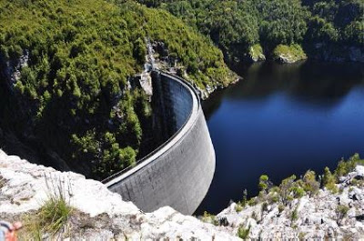

Figure 1: Earth and Rockfill Dam

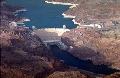

Figure 2: Arc Dam

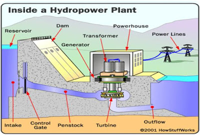

Figure 4: Schmatic of a Hydropower Plant
The various components of HPP are as follows:
  1. Catchment area
  2. Reservoir
  3. Dam
  4. Spillways
  5. Conduits
  6. Surge tanks
  7. Draft tubes
  8. Power house

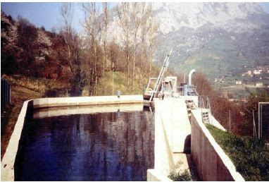

|400x270
Figure 5: Forebay
