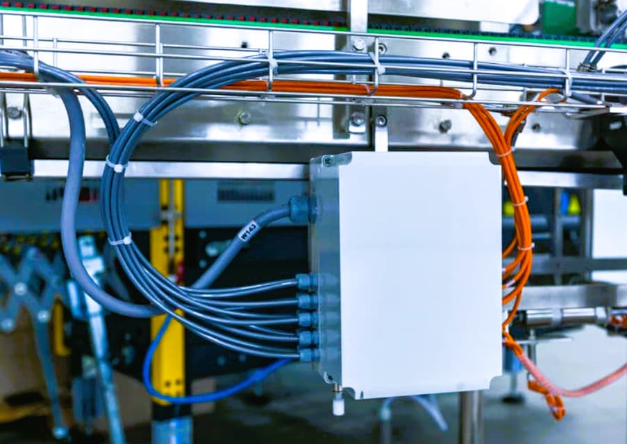

Junction boxes are an integral part of every electrical, control, and instrumentation installation.
For control and instrumentation, it is an enclosure used for interconnection between field devices (i.e., instruments) in the process/production areas and control/monitoring equipment typically located in the control room.
Junction Box
The junction box is typically used for terminating multiple field devices of common systems in a general area.
Instrument junction boxes should be designed to suit the environmental conditions of the intended locations. It should have certification to demonstrate proper ingress protection (IP) and hazardous area protection.
