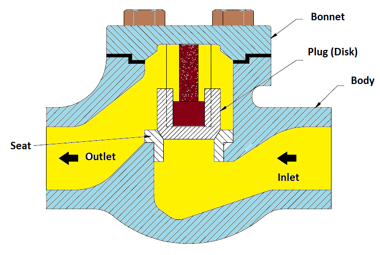

Lift type Check Valve How it Works?
Construction of lift check valve is similar to globe type valve. As the flow enters, the disk or ball is raised within guides from the seat by the pressure of the upward flow.
When the flow stops or reverses, the disk or ball is forced onto the seat of the valve by both the backflow and gravity.Lift type check valves are available in three body patterns: horizontal, angle, and vertical.
Point to remember: Flow to lift check valves must always enter below the seat.
