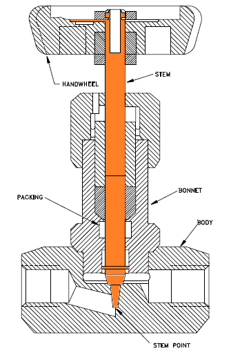

What is a Needle Valve
A needle valve is linear motion valve used to make relatively fine adjustments in the amount of fluid flow.
The distinguishing characteristic of a needle valve is the long, tapered, needle like point on the end of the valve stem. This “needle” acts as a disk. The longer part of the needle is smaller than the orifice in the valve seat and passes through the orifice before the needle seats. This arrangement permits a very gradual increase or decrease in the size of the opening in a needle valve.
