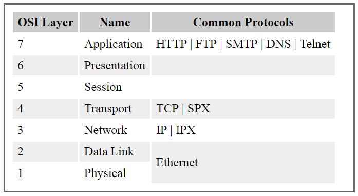

The OSI (Open Systems Interconnection) Reference Model defines seven layers of networking protocols. The complexity of these layers is beyond the scope of this tutorial; however, they can be simplified into four layers to help identify some of the protocols with which you should be familiar
Fig : OSI model related to common network protocols
Figure illustrates how some of the major protocols would correlate to the OSI model in order to communicate via the Internet. In this model, there are four layers, including:
- Ethernet (Physical/Data Link Layers)
- IP/IPX (Network Layer)
- TCP/SPX (Transport Layer)
- HTTP, FTP, Telnet, SMTP, and DNS(combined Session/Presentation/Application Layers)
