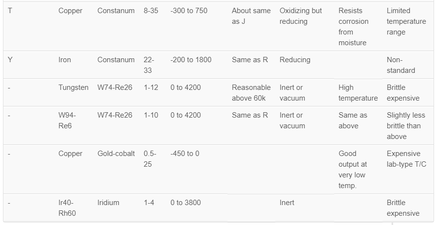

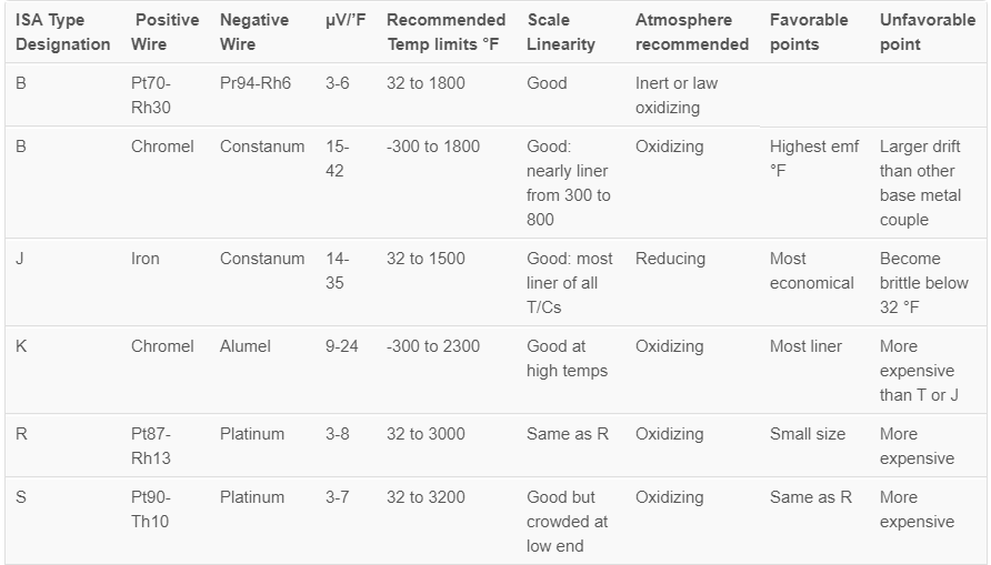

Thermocouples are the most common sensors for measuring temperature in industrial use. It consists of two dissimilar metals such as iron and constantan electrically, they joined together at one end. When the junction of the two metals is heated or cooled a voltage is produced that can be correlated back to the temperature.
The voltage across the thermocouple increases as the temperature rises. A suitably calibrated instrument, capable of measuring small voltages can be used to measure the change. The process temperature is obtained from the voltage, either from a graph or by using thermocouple tables. Thermocouple tables list the voltages corresponding to each temperature.
A table is required for each thermocouple type. The relationship between millivolts and temperature is not linear. In microprocessor-based equipment, the conversion is done based on the data stored in the device.
