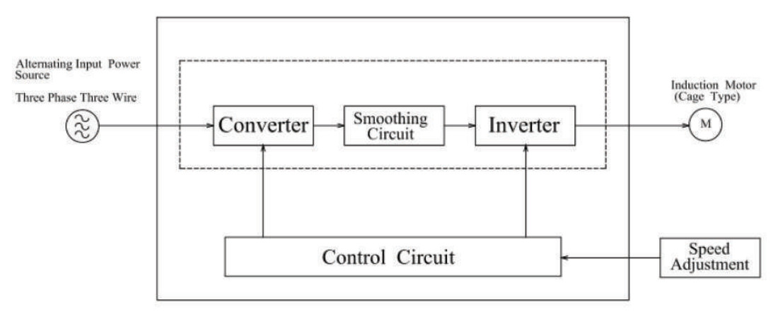

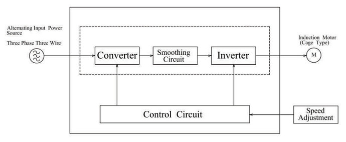

The fundamental configuration is shown in Figure.
After changing an alternating power source into direct current in a converter part and making it smooth, transform the direct current inversely to variable frequency alternating current at an inverter part.
