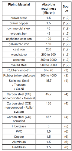

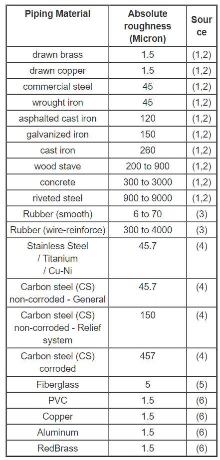

Pipe absolute roughness
Pipe absolute roughness (e) tabulated are taken from from several sources. These values are for new pipes and typically for new design purpose. For aged pipes or debottlenecking purpose, higher roughness are expected.
Piping Material Absolute roughness
- 1m = 1,000 mm = 1,000,000 micron ; 1 mm = 1,000 micron
Pipe Relative roughness
Relative pipe roughness is the ratio of absolute roughness ( e) by and pipe diameter (D) :
Relative Pipe Roughness = e/D
