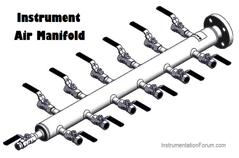

What is an Air Manifold?
Air manifold or Instrument air distribution manifold is a pipe shaped chamber (manifold) with several branches of outlets for delivering instrument air to multiple consumers such as control valve, actuated valve or other pneumatic operated instrument.
Air Manifold
The number of outlet of an instrument air distribution manifold may vary depend on the number of nearby pneumatic instrument or valve. Each outlet is fitted with block valve which could be of ball valve or needle valve type. Each outlet should have instrument tag number to which the outlet delivered the instrument air.
At the bottom of instrument air distribution manifold, a block valve is fitted for drain purpose. This drain valve is required during maintenance to bleed the built-up condensed liquid.
