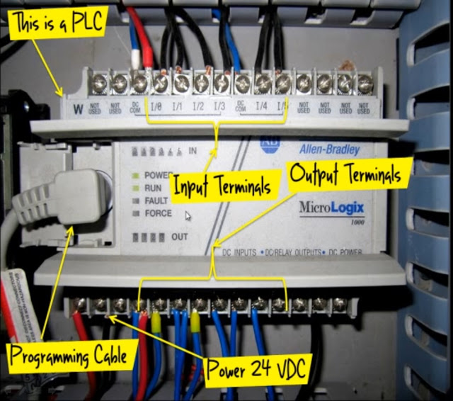

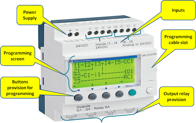

2. Programmable logic controllers

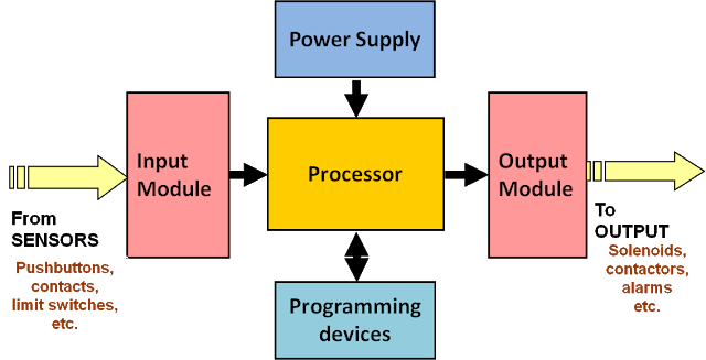

A programmable logic controller (PLC), or programmable controller is an industrial digital computer which has been ruggedized and adapted for the control of manufacturing processes, such as assembly lines, or robotic devices, or any activity that requires high reliability control and ease of programming and process fault diagnosis.
What is inside PLC ?
A programmable logic controller (PLC), is a like a microcontroller which is used for doing so many applications.
It basically consist of
CPU with processor and program memory
Power supply
Input module
Output module
Control bus
1. Parts of Delta PLC
2. Parts of Allen Bradley PLC
3. Parts of Siemens PLC
4. Parts of Zelio Schneider electric PLC

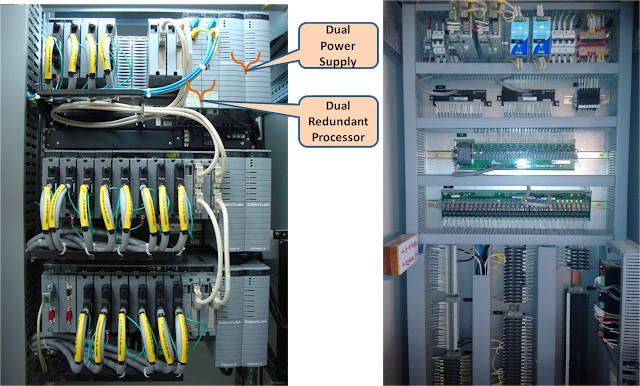

Distribution of I/O’s through controller
Distributed control system (DCS)
System cabinets and Marshalling cabinets of DCS
System and Marshalling cabinet arrangement
Various DCS and Hybrid DCS providing companies
DCS
Yokogawa (Centum VP)
Honeywell (EPKS)
Emerson (Delta V)
Forbes Marshall
Hybrid DCS
- Allen Bradley (Compact logix and control logix)

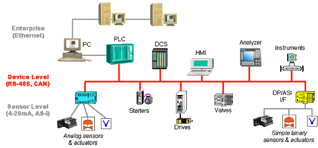

Various Communication protocol used in DCS or PLC systems and its hierarchy
LAN (Ethernet)
Modbus, CAN, Serial communication
OPC (OLE for Process Control)
Control NET
Foundation Field bus
Profibus (DP,PA)
Device NET

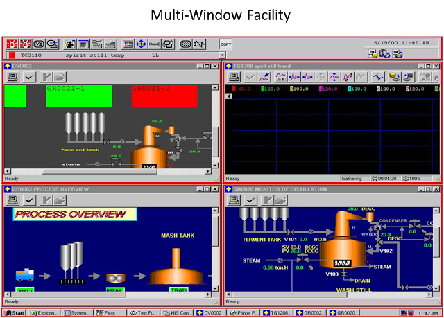

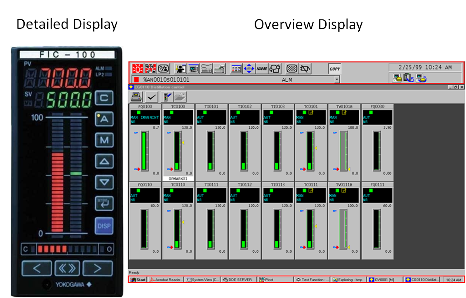

Supervisory Control and Data Acquisition software (SCADA)
SCADA (supervisory control and data acquisition) is a category of software application program for process control, the gathering of data in real time from remote locations in order to control equipment and conditions.
Features of typical SCADA software
Dynamic process graphic
Real-time and Historical trending
Alarms
Recipe Management
Security
Device connectivity
Script for logic development
Database connectivity
Displays used for monitoring in SCADA systems
