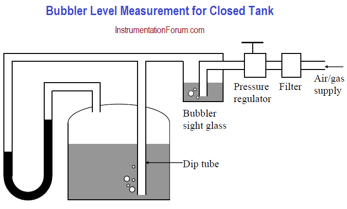

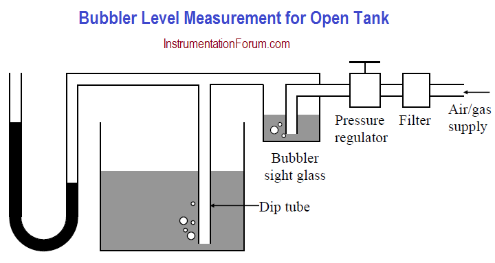

A constant flow of compressed air or an inert gas (usually nitrogen), is introduced through a dip tube. The pressure required to force bubbles through the tube at a constant rate (normally 60 bubbles per minute), is proportional to the hydrostatic pressure at the bottom end of the dip tube.
A bubbler sight glass, facilitate with adjusting the bubble rate. The level is determined from the difference between the bubbler pressure (back pressure) and the pressure at the surface of the liquid, by means of a DP transmitter or manometer.

Figures, depicts the measurement arrangement for an open tank and a closed tank respectively, using a u-tube manometer.
