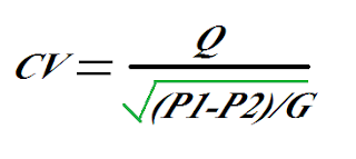

Valve sizing coefficient ‘Cv’ is defined as the number of US gallons per minute of water that will pass through a given restriction with a pressure drop of one psi.
This is basic equation for liquid calculations, in volumetric flow Where -
Q - flow rate in US gpm
P1 - upstream pressure in psia
P2 - downstream pressure in psia
G - liquid specific gravity @ flowing temp.
