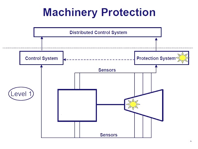

The first level of machinery management is monitoring and protection. The condition monitoring System provides this level of machinery management.
Monitoring is accomplished by using various transducers and sensors, which translate measurable machine and process condition parameters into electrical signals. These signals are accessed and displayed by the condition monitoring System modules.
Condition Monitoring system
CMS can also provide protection by comparing machine and process conditions to predetermined alarm levels. A report of conditions that may be in excess of the alarm levels can be used to change the state of the machine to a safe operating mode or even tripping the machine.
