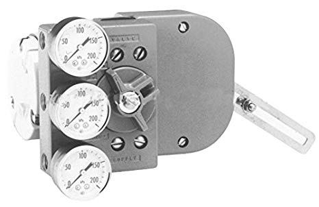

Positioner comes equipped with three gauges,
- To indicate the air supply signal
- To indicate instrument signal (Normally comes from I/P converter).
- To indicate output signal (Given to the pneumatic control valve).
There are 3 pressure gauges in control valve positioner .
1.Instrument (Input).
2.Valve (Output).
3.Supply.
Instrument air comes from an i/p converter(0.2 to 1.0 kg/cm^2)
Valve air supplied to control valve.
Supply Air is an air supply for pneumatic positioner.

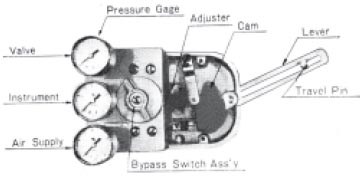

Control valve positioner
pneumatic valve positioner
Parts of a pneumatic control valve positioner
Adjuster
the adjuster is used to adjusting the position of a control valve if the control valve is not fully closed or opened after giving signal it can be closed or opened by adjuster screw.
Cam
Cam is used to operate a pneumatic control valve.
Bypass Switch Assembly
Bypass Switch Assemble has 2 positions
- Positioner.
- Bypass.
In bypass position control valve operation is only closed or opened. % opening is not performed in the bypass position.
In Positioner mode position % (percentage) opening is performed.
Travel pin
Travel pin provides connection between positioner and control valve.
