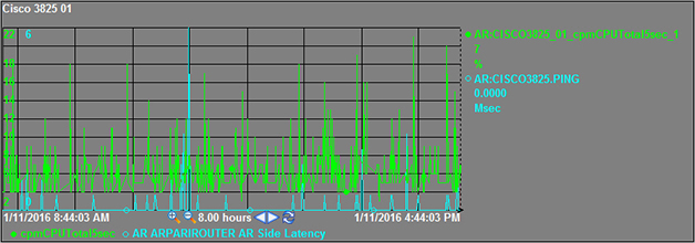

Time series information is often displayed in a trend or as tabular data over a time range (ex. the last day, last 8 hours, last year).

![Time Series databases are critical to the efficient storage and retrieval of historical data, but this time series data becomes far more powerful and accessible when it is connected to a asset or equipment hierarchy.]
