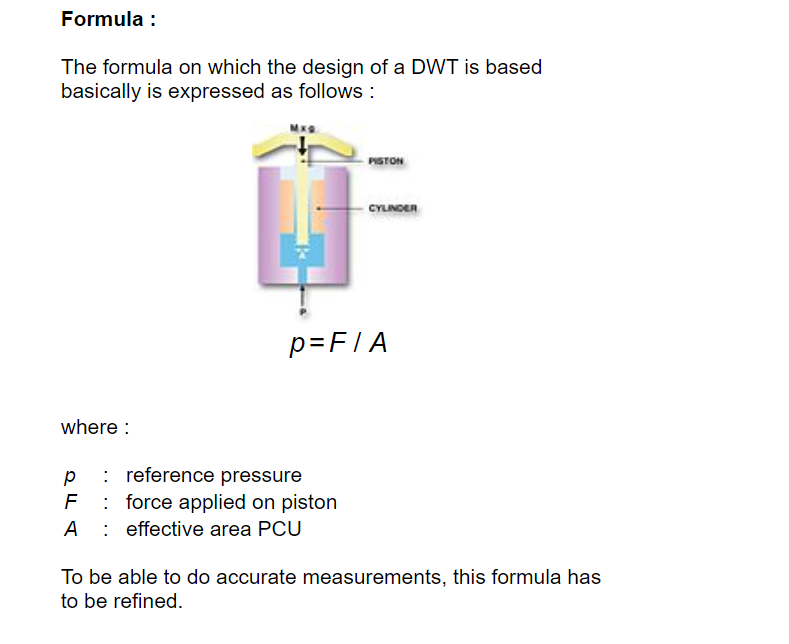

Dead weight testers are named so because they utilize dead weights in determination of pressures operating in a closed and compressed fluid system.
They are so called because of the reason that for each value of pressure to be exerted/ applied in the closed hydraulic system, a predetermined / fixed amount of weights are used to exert the force to counter balance the buoyancy forces.
Each weight is stamped with the equivalent amount of force that will be exerted on a predetermined area of piston cylinder arrangement by using that weight. There fore the device is called Dead Weight tester.

DWT (Dead Weight Tester) is based on the principle of Pascal’s law. The law states that in a closed system of incompressible fluid, the pressure applied will exert equal amount of force in all the directions. In DWT system, silicon oil is used within the closed boundaries of the Piston cylinder arrangement, piping, pressurisation chamber and in the head on which the gauge to be tested/ calibrated is fixed.
The oil is taken in to the pressurisation chamber from oil bowl and all the air entrapped is vented off. This is because of the reason that air is compressible and hence do not allow pressure to be exerted equally in all the areas and there by create error in the test results.
Once the system is full with air free oil, pressure is gradually increased from the pressurization chamber. Oil pressure starts increasing in all the areas including piston cylinder arrangement over which the dead weights are mounted.
As the force increases gradually and equals the amount of down ward force being exerted by the dead weights, the total system gains the state of equilibrium and just at that moment, the dead weights starts getting lifted up. At this condition, the amount of force operating in the entire system is same.
