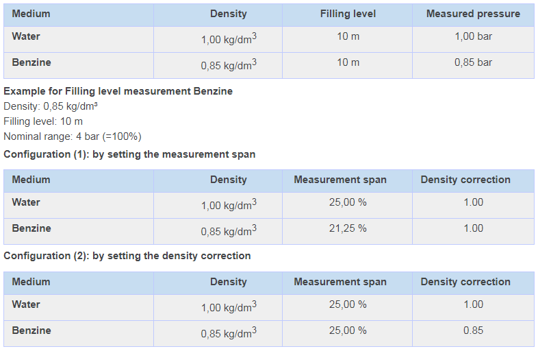

For measuring the filling level of liquids with a density that is other than 1.0 kg/dm³ (i.e. not the same as water).
For instance: 0.85 kg/dm³ (benzine) can be selected in two different ways:
- by adjusting the span
- by adjusting the density correction
The final result is the same in both cases.
The second method, using the density adjustment parameter, is easier for the user if the density changes from time to time, as it can then be manually corrected by using the keys on the instrument.
