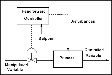

In Feedforward Control configuration, a sensor or measuring device is used to directly measure the disturbance as it enters the process and the sensor transmits this information to the feedforward controller.
The feedforward controller determines the needed change in the manipulated variable, so that, when the effect of the disturbance is combined with the effect of the change in the manipulated variable, there will be no change in the controlled variable at all.
The controlled variable is always kept at its setpoint and hence disturbances have no efffect on the process. This perfect compensation is a difficult goal to obtain. It is , however, the objective for which feedforward control is structural.

A typical feedforward control loop is shown in the figure below.

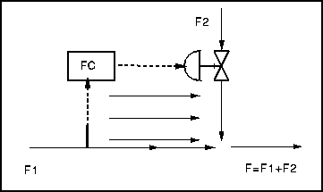

Another name for feedforward control is open loop control. The reason is that the measured signal goes to the controller parallely to the process.
This can be seen in the next figure. This is in contrast to feedback or closed loop control.
