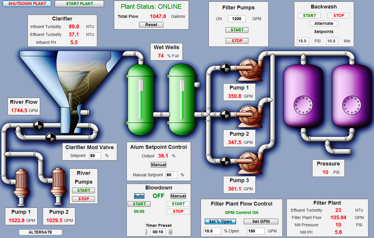

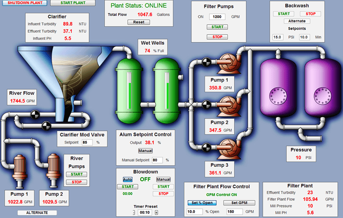

SCADA is not just pictorial view of the plant but much more.
SCADA= S upervisory C ontrol A nd Data A cquisition.
It has graphical user interface which displays critical control and process flow at centralized control room.
This gives ability to the process engineers a bird’s eye view on whats happening in the process. For e.g. current/past values/trends of the process variables such as temperature, pressure, humidity etc are displayed.
Also, if required, process engineer can change ‘control set point’ of the process parameters from centralized control room.
In short process engineer can view or change process parameters from centralized location through graphical interface.
Second important aspect of SCADA is Data Acquisition. Vital information of the process is collected and stored for analysis.
