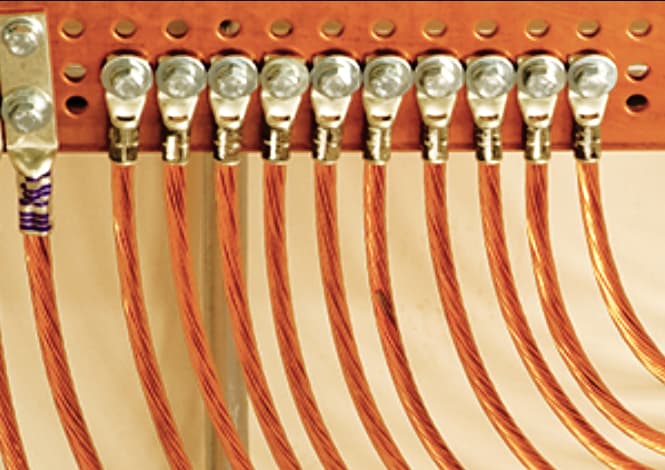

In an ideal situation, all components of an electrical system should share a common ground reference point, often called a “star point,” where all ground paths converge. However, in many installations, devices might be grounded at different locations. The problem here is that if there is any electrical potential difference between these grounding points, it can cause an unwanted current to flow through the signal path. This is what is referred to as a “ground loop.”

  1. Star Grounding: Try to establish a single ground or “star” point that all devices connect to. This can eliminate the potential difference between multiple ground points, thus preventing ground loops.
