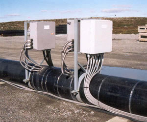

The choice of cable and controls is dependent on the type of pipe being used. Heat tracing cables may be installed continuously on water and sewer lines, or only at specific locations which are susceptible to freezing such as road crossings, fire hydrants, shallow bury locations, etc.
The electric heat tracing must maintain the pipe temperature above 0°C (32°F) when exposed to the lowest design ambient temperature while at no flow conditions.
The installed power capacity must compensate for heat loss through the pipe insulation and include a safety factor.
