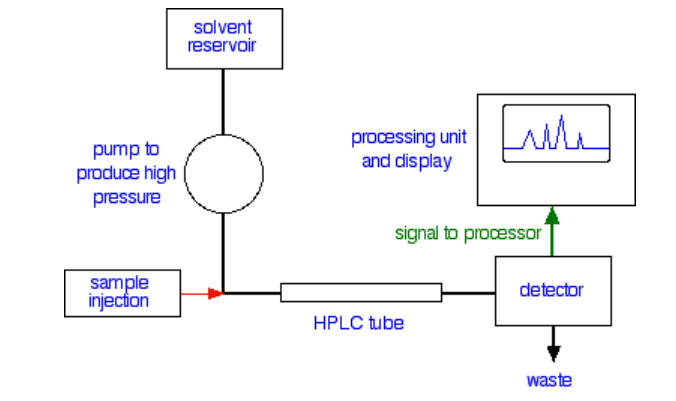

High Performance Liquid Chromatography
A flow diagram for HPLC looks like this
HPLC is an advance on column chromatography where the solvent is forced through the column at a very high pressure of up to 400 atmospheres. This makes the whole process much faster, but also allows you to use a much smaller particle size in the column
