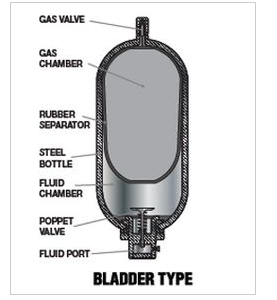

Bladder type accumulator

Bladder Accumulator
Fluids are not in compressible and cannot store pressure energy, but gas can be compressed so it is used for storing fluids in accumulator.The accumulator consists of a shell. The shell consist of fluid section and gas section.
The gas section has a bladder which is filled with nitrogen gas. Surrounding the bladder is the fluid.The bladder can be expanded and compressed for storing and releasing the fluid.
The fluid section is connected to the hydraulic section i.e poppet valve for drawing the fluid into the accumulator when the fluid pressure is higher and compresses the bladder with gas.so the fluid is stored inside the accumulator.when the fluid pressure in the line drops the bladder expands and forces the stored fluid in the hydraulic circuit with the pump flow.
The accumulator bladder is pre pressurised with nitrogen gas upto 2.3bar. The bladder gas pressure is set 70% to 80 %of the hydraulic circuit pressure.
