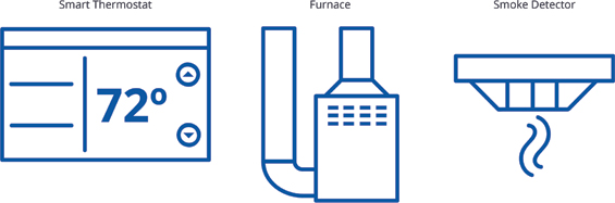

To clarify our thoughts, a simple automation system will be considered. Figure 1 shows a simple automation system. The system consists of a temperature sensor, smoke detector, and a furnace. The objective is to enable the furnace when the temperature is below the setpoint and disable the furnace when the smoke level is above the setpoint.
Figure 1 – Automation system before integration

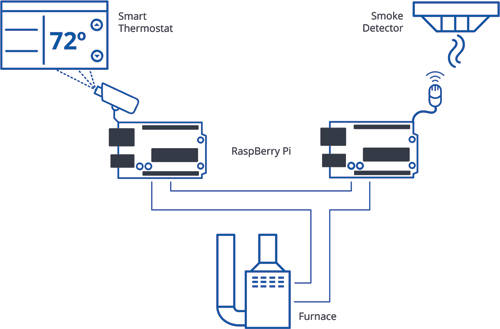

One way to design this system is to purchase a thermostat, a smoke detector, and a furnace then ‘integrate the system.’ We purchase a wireless smart ZigBee thermostat, a wall-mounted smoke detector, and a furnace designed for a wired thermostat. All we do is integrate the automation system.
Our first problem is that the thermostat and furnace use incompatible protocols. We can fix that by purchasing a camera and also purchase a Raspberry Pi kit with one relay output; then just apply some custom software to convert the picture of the thermostat display into a contact output (very easy!).
Next problem is that the smoke detector protocol (audio output) is incompatible with everything else. We just need to buy another Raspberry Pi kit with a microphone input which converts the sound to a contact opening. Wire this in series with the other Raspberry Pi kit then wire to the furnace.
Now it is time to test the system. Because it is summertime and daylight, we assign a low-temperature setpoint and we find that the furnace turns on, so we are done. Discard all the packaging (and instructions and wiring diagrams and source code) because the integration test was successful. Figure 2 shows the resulting system.

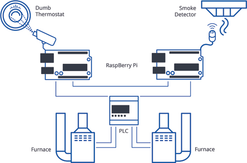

Figure 2 – Automation system after initial integration
Four months later, the house gets cold at night. We forgot that the thermostat display has no backlight. Simple enough to fix, just leave the lights on at all times (and pay for the extra power to run the light).
Two months later, the house gets cold even during the day. We forgot to buy a large enough furnace, need to buy another one. But now we cannot control both furnaces from a single contact closure. So we buy a Programmable Logic Controller with one input and two outputs. Program the controller and now we have a warm house.
A few years later, the thermostat malfunctions and the replacement has a different display style. No problem, just modify the Raspberry Pi code… where did we put that source code? Figure 3 illustrates the final system.
