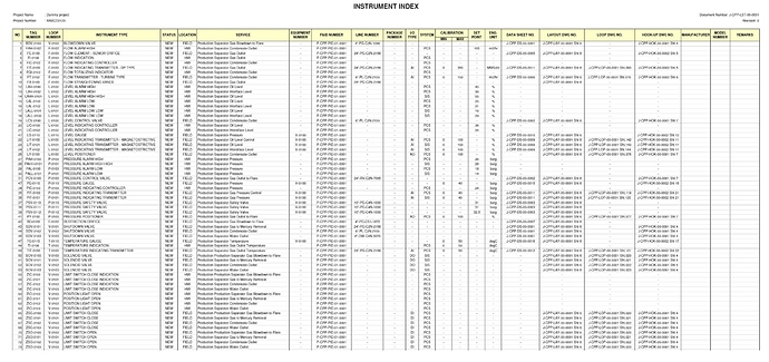

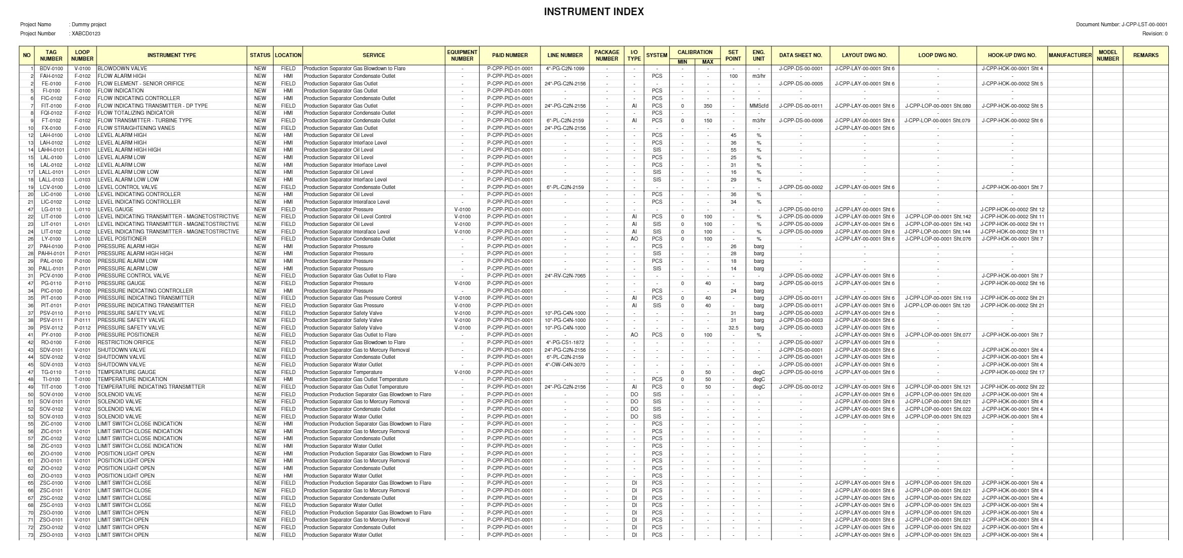

The following link is typical instrument index (for example only):
