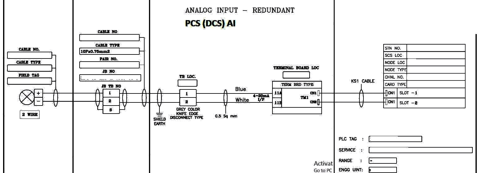

Loop diagram shows instrument (in a symbol) and its terminal numbers which are to be connected, instrument cable number, junction box number, terminal number assigned for the specified instrument, multi-pair cable and pair number , marshalling cabinet number, terminal number in marshalling cabinet, control system details (rack, slot, I/O channel). It also clearly indicates location of each equipment by means of border line as a limit.
Loop Diagram usually shows a single control loop which means it could only contains just one input (sensor to control system), just one output (control system to final element) or combination of both

It is used in checking of a correct installation and connection when tested during pre-commissioning, commissioning and also for trouble shooting during operations
A typical loop diagrams is as shown below
Let me explain every loop and its characteristics one by one……………
A) PCS/DCS LOOP

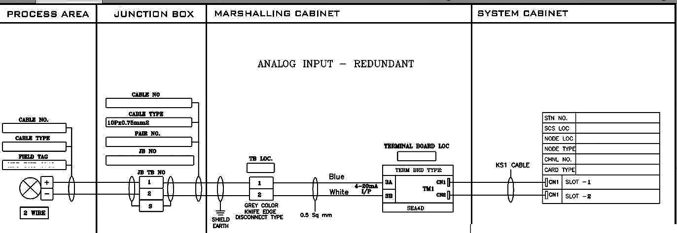

1)PCS LOOP AI (ANALOG INPUT)
Characteristics of loop
a)Primary cable (cable laid from marshalling cabinet to JB) will be of 20 pair X 0.75 sqmm. And secondary cable (cable laid from JB to field) will be 1pair X 0.75 sqmm. shielded cables
b)There will not be any 24V power supply in general case {240V flow transmitters are exceptions}, the 4 to 20mA is fed from control room AI cards
c)The card will be for the purpose of control monitoring type like (Yokogawa Centum CS/ Centum VP, Siemens SimaticPCS7 Emerson delta V,ABB System800xA,Honeywell ST3000 and Experion PKS, GE OC4000,Rockwell PlantPAx, Invensys Foxboro IA series)
d)This loop will provide the present parameters of the system like current level, pressure, temperature, flow etc in terms of mA
e)The fuse used in the TB will be of the type Grey colour knife edge disconnect type fuse.

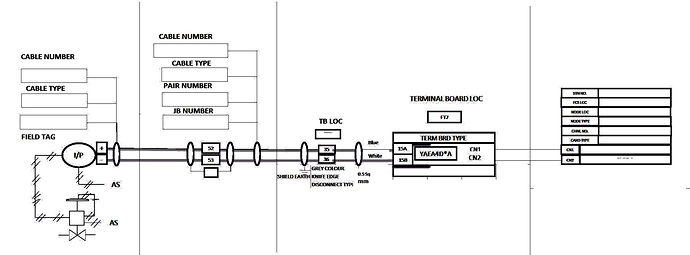

2)PCS LOOP(AO) ANALOG OUTPUT:
a)Primary cable (cable laid from marshalling cabinet to JB) will be of 20 pair X 0.75 sqmm. And secondary cable (cable laid from JB to field) will be 1pairX0.75 sqmm. Shielded cables
b)There will not be any 24V power supply in general case {240V flow transmitters are exceptions}, the 4 to 20mA is fed from control room AO cards
c)The card will be of purpose of control/monitoring type like (Yokogawa Centum CS/ Centum VP, Siemens SimaticPCS7 Emerson delta V,ABB System800xA,Honeywell ST3000 and Experion PKS, GE OC4000,Rockwell PlantPAx, Invensys Foxboro IA series)
d)This loop will provide the command signal for controlling of the system like current level, pressure, temperature, flow control valves in terms of mA
e. The fuse used in the TB will be of the type Grey colour knife edge disconnect type fuse.

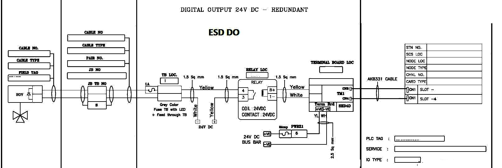

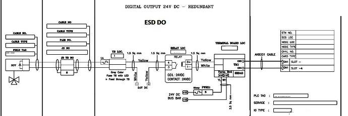

1)ESD DIGITAL OUTPUT (DO) LOOP:
a)Primary cable (cable laid from marshalling cabinet to JB) will be of 20 Core X 2.5 sqmm. And secondary cable (cable laid from JB to field) will be 2Core X 2.5 sqmm. shielded cables
b)There will be one(not 2 as in case of DCS DO) 24V power supplies in general case, for open/close command for ON/OFF valve SOVs along with relay and another 24 V in the loop between TB and relay
c)The card will be of purpose of emergency shutdown type (Yokogawa Prosafe RS, Invensys triconex,Honeywell Fail safe controller as a part of Experion/TPS,siemens S7-400F,Emerson deltaV SMART SIS,ABB 800xA High Integrty SIS)
d)The fuse used in the feed through TB will be of the type Grey colour fuse TB with LED disconnect type fuse of value 1A for the loop and one fuse of 2A for terminal board 24 volt DC power supply bus bar

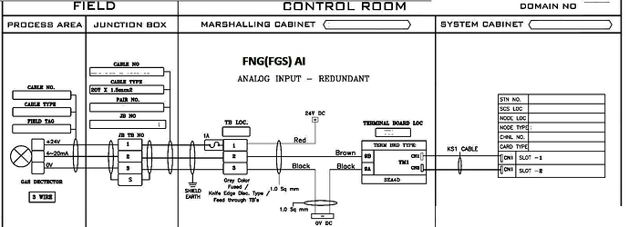

1)FNG ANALOG INPUT(AI) LOOP:
a)Primary cable (cable laid from marshalling cabinet to JB) will be of 20 Triad X 1.5 sqmm. And secondary cable (cable laid from JB to field) will be 1Triad X1.5 sqmm. Shielded cables
b)There will be one 24V power supply and one 0 volt supply in general case, the 24 volt is fed for the first cable of the triad and 0 volt is fed to last cable of the triad
c)The card will be for the purpose of control monitoring type like (Yokogawa Prosafe RS, Invensys triconex,Siemens S7-400FH,Honeywell HS81-HSController,Emerson DeltaV SIS system)
d)This loop will provide the controlling/monitoring parameters of the system like gas LEL, flame quotient etc in terms of mA
e)The fuse used in the TB will be of the type Grey colour knife edge disconnect type fuse for 24 volt loop and knife edge for mA loop

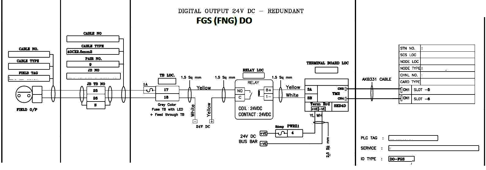

2)FNG DIGITAL OUTPUT (DO) LOOP :
a)Primary cable (cable laid from marshalling cabinet to JB) will be of 40 Core X 2.5/1.5 sqmm. And secondary cable (cable laid from JB to field) will be 2Core X 2.5/1.0 sqmm. shielded cables
c)The card will be of purpose of emergency shutdown type (Yokogawa Prosafe RS, Invensys triconex,Siemens S7-400FH,Honeywell HS81-HSController,Emerson DeltaV SIS system)
