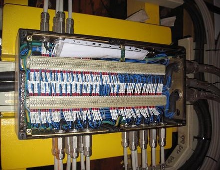

Below is picture of instrument junction box:
individual cables and overall screen of multipair cable.
