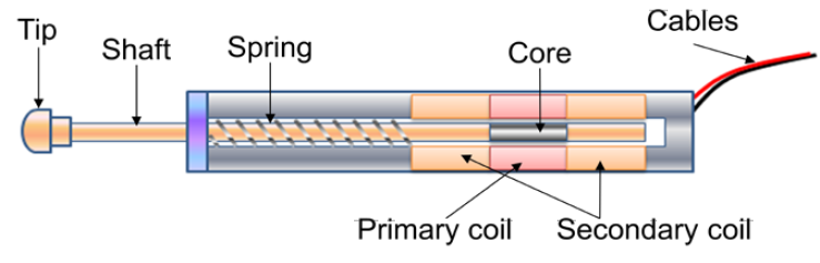

It has non-linearity error ± 0.25% of full range. Above Figure shows the construction of a LVDT sensor. It has three coils symmetrically spaced along an insulated tube.
The central coil is primary coil and the other two are secondary coils. Secondary coils are connected in series in such a way that their outputs oppose each other.
A magnetic core attached to the element of which displacement is to be monitored is placed inside the insulated tube.

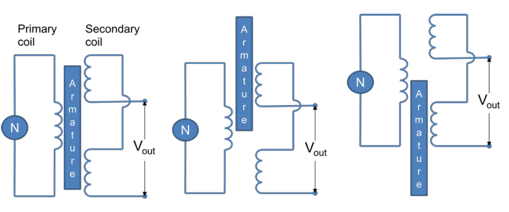

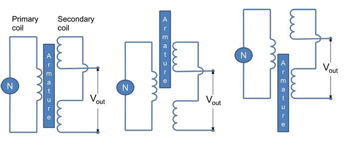

Due to an alternating voltage input to the primary coil, alternating electro-magnetic forces (emfs) are generated in secondary coils.
When the magnetic core is centrally placed with its half portion in each of the secondary coil regions then the resultant voltage is zero. If the core is displaced from the central position as shown in above Figure, say, more in secondary coil 1 than in coil 2, then more emf is generated in one coil i.e. coil 1 than the other, and there is a resultant voltage from the coils.
If the magnetic core is further displaced, then the value of resultant voltage increases in proportion with the displacement. With the help of signal processing devices such as low pass filters and demodulators, precise displacement can be measured by using LVDT sensors.
