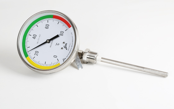

Mercury filled system based on mercury expansion principle is used for measuring temperature ranging from (-) 40°C to 650°C.
It has faster response and the same is available in rigid stem as well as capillary type for remote sensing. Every angle type can be offered in all SS construction.
Manufactured in accordance with BS:5235.
System is case compensated as standard (SAMA Cl VB). Fully compensated (capillary compensation), Double Bourdon system is also offered wherever essential.
