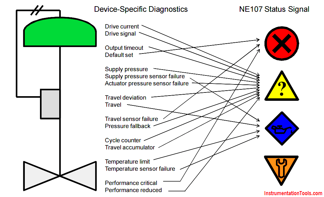

This is similar to the Standard Analog Signal, NAMUR NE43 compliant transmitters/PLc analog output are designed to signals greater than 20 mA & less than the 4 MA to Base signal, allowing for a small amount of Signal Saturation. To be compliant to NAMUR NE43, the device are set in the factory to have an Analog -LL and Analog-UL of 3.8 mA and 20.5 mA respectively.
The analog Signal also has values designed to indicate a self-diagnosed hardware failure, loop open or Burnout. Once it’s determined, the analog output holds at ≤3.2 mA or ≥21.6 mA.
Does your system, sensor or transmitter comply with the Namur NE43 recommendation? In this caser analog signal fault can be represented by a current higher than 21 mA or lower than 3 mA. Is your software/system capable to handle all these situations, fault diagnostics and?
