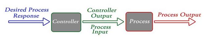

The block diagram of open loop control system in which process output is totally independent of controller action.
