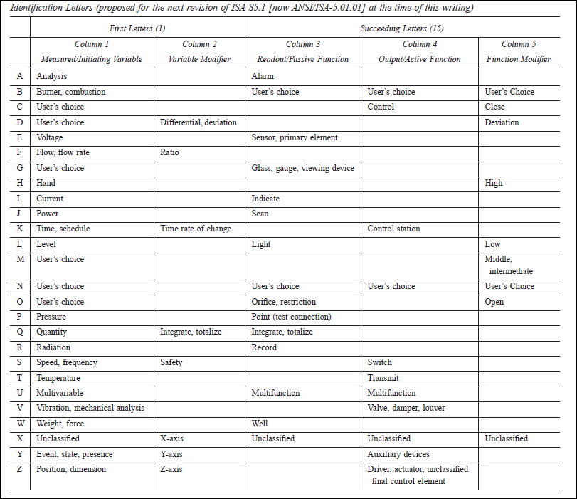

Identification of letters in P&ID
The instrument symbols used on PEFS shall indicate the functionality of the loop. For DCS and general instrumentation the symbols shall indicate which process condition or property is being measured and controlled and what information is displayed.
For safety related function (e.g. IPFs- Instrumented Protective Function ) the symbols shall indicate which process condition or property is being measured and what information is displayed.
All components and functions of the loop shall carry the same tag number. The numbering shall be unique at loop level.
Each instrument shall have a tag number of the format:
abc yz
in which:
β€˜a’ is a three digit number used to identify the process unit.
β€˜b’ is a measured variable code: one capital letter code identifies the process condition, property measured or initiating variable. Where required, an additional modifier letter is added. (see the 1st letter identification table)
β€˜c’ is a function code: one or more capital letter codes identify the function of the instrument or loop. (see the 2st letter identification table) is a separation dash, used for clarity
β€˜y’ is a three digit serial number (i.e. from 001 through 999)
β€˜z’ is an optional suffix which may be used to make a loop component uniquely identifiable; only to be used if required.

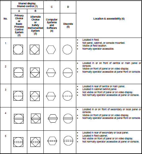

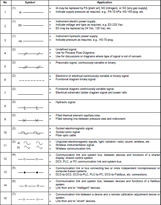

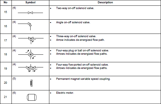

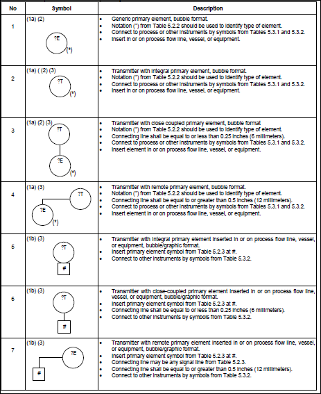

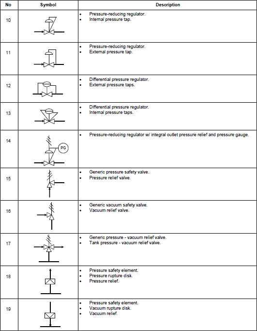

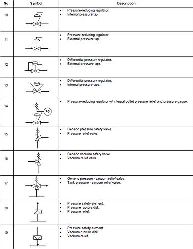

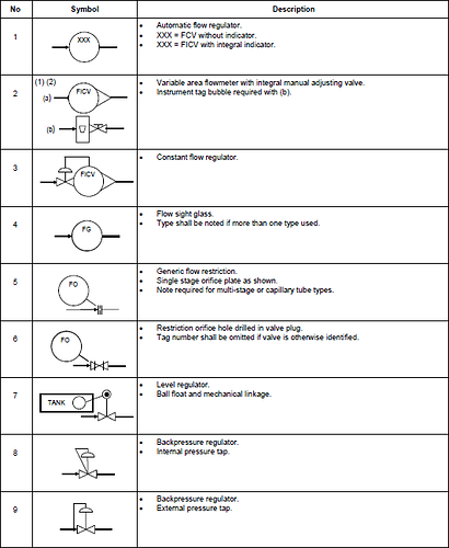

Instrumentation device and function symbols (As Per ISA 5.1 – 2009)

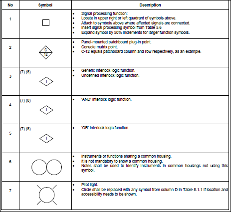

Instrumentation device or function symbols, miscellaneous

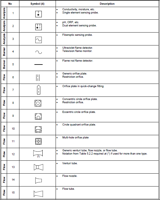

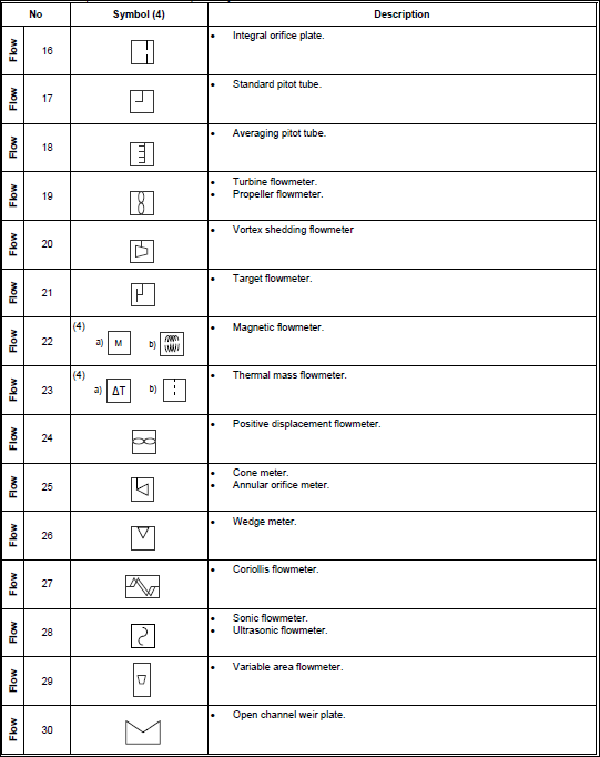

Measurement symbols: primary elements and transmitters

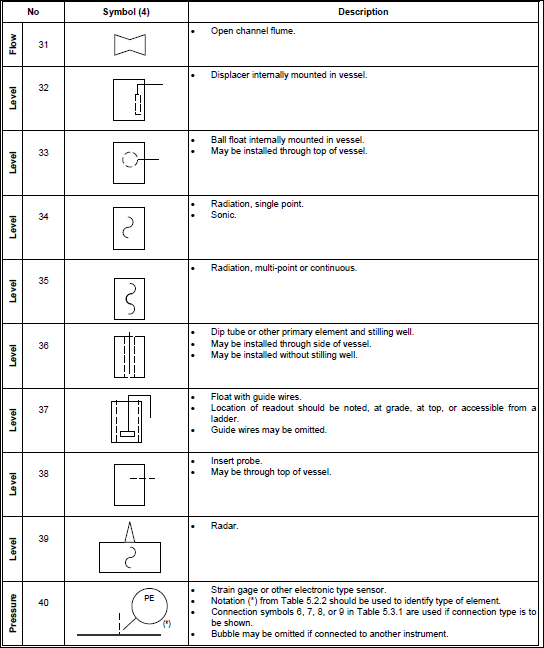

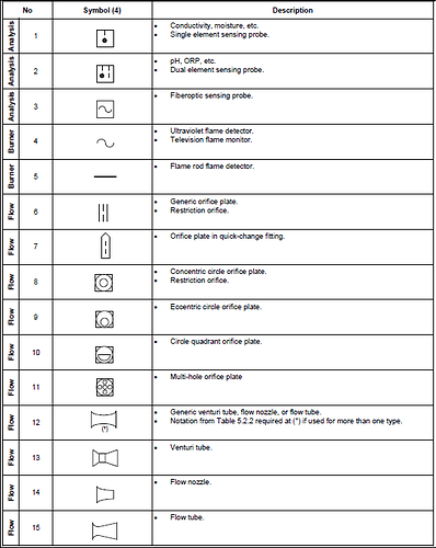

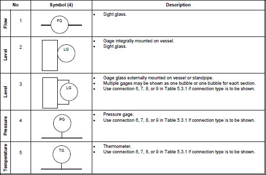

Measurement symbols: secondary instruments

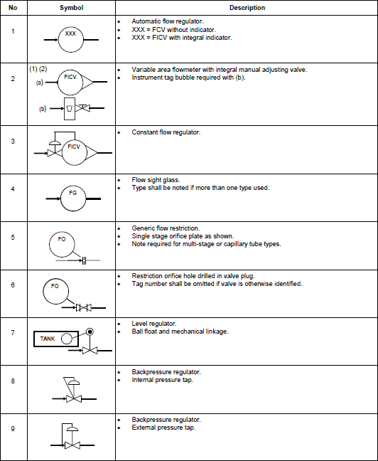

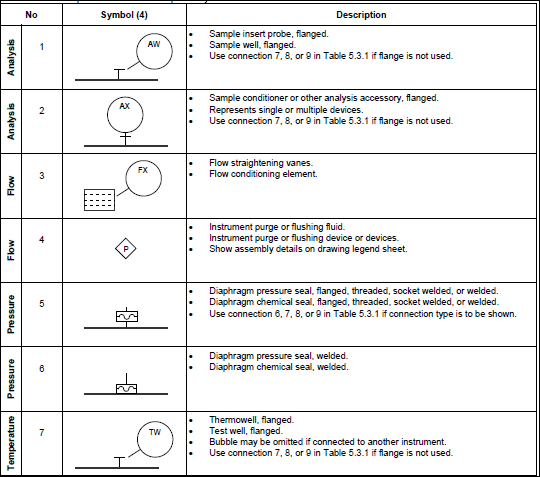

Measurement symbols: auxiliary and accessory devices

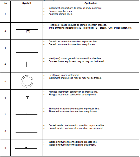

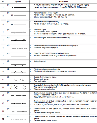

Line symbols: instrument to process and equipment connections

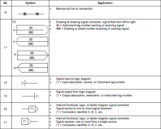

Line symbols: instrument-to-instrument connections

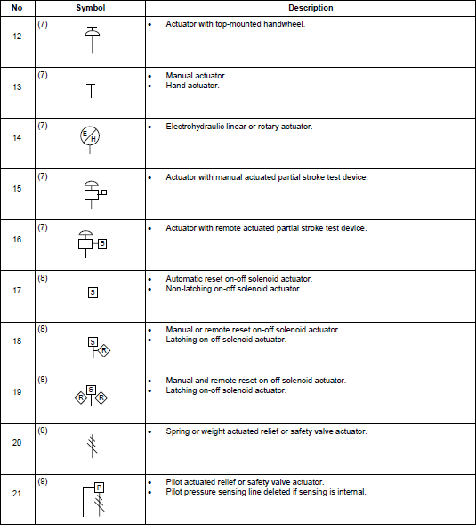

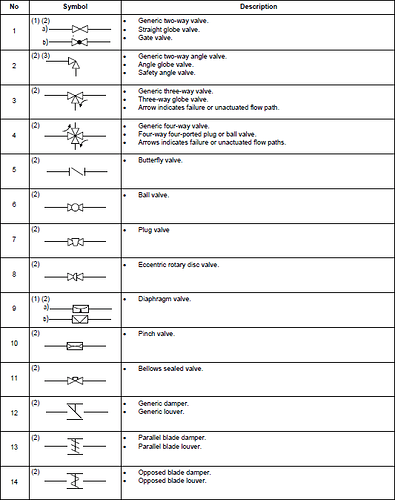

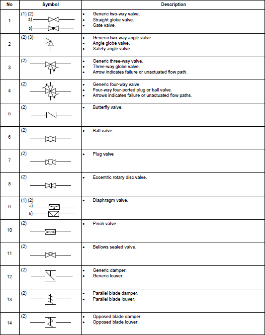

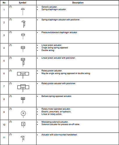

Final control element symbols

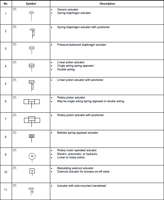

Final control element actuator symbols
Self-actuated final control element symbol
Control valve failure and de-energized position indications
