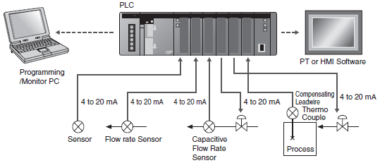

The above diagram shows us the basic operation of plc. In the diagram we can see that all the input sensing devices such as Pressure & Temperature sensors, Flow rate sensors are sending its signal to the controller which is analog(4-20mA)in nature.
As i said in my previous post on DCS, All the control systems must be first convert analog input data into digital form before it can be processed & similarly the processed digital output data must be convert into analog form. Why we preferrably use 4-20mA rather than 0-5V or 0-20mA will be discuss in next post.

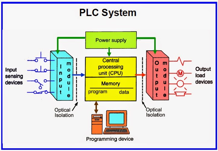

The basic components of PLC are,
1)Power Supply
2)Input module
3)CPU
4)Output module
In the above diagram, We can see the architecture of a plc system. Lets go to the functionalities of every component of plc.

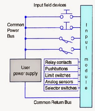

INPUT MODULE:
As we see in the figure, Input module receives the signals from input field devices such as sensors, pushbuttons and sends them to the CPU of the system for processing. All the input field devices are physically wired to the input module.
CPU:
CPU is the brain of the PLC, It takes the input data from various sensing devices through the input module and executes the stored program in the memory and sends an appropriate output command to the output module to control the output devices.

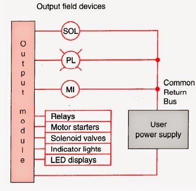

OUTPUT MODULE:
This module receives commands from the CPU of the system and send a output signal to the field devices such as motors, solenoid valves to change its state.
