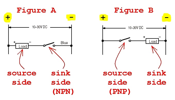

Suppose that you have a SOURCING-TYPE PLC input module (for example type 1746-IV16) … that module would play the part of the “LOAD” in Figure A above … the solid state sensor that you’d need to connect would be a SINKING-TYPE sensor – also known as an NPN-type sensor …
notice that the description above gives us ONE “sourcing-type” device and ONE “sinking-type” device to use in our circuit … the “sourcing device” goes on the PLUS/POSITIVE side … the “sinking device” goes on the MINUS/NEGATIVE side …
now then …
suppose that you have a SINKING-TYPE PLC input module (for example type 1746-IB16) … that module would play the part of the “LOAD” in Figure B above … the solid-state sensor that you’d need to connect would be a SOURCING-TYPE sensor - also known as a PNP-type sensor …
notice that (just like before) the description above gives us ONE “sourcing-type” device and ONE “sinking-type” device to use in our circuit … and (once again) the “sourcing device” goes on the PLUS/POSITIVE side … the “sinking device” goes on the MINUS/NEGATIVE side …
going one step further …
now instead of input modules suppose that we talk about the PLC output modules instead …
suppose that you have a SINKING-TYPE PLC output module (for example type 1746-OV16) … that module would play the part of the “SWITCH” in Figure A above … the “LOAD” that you’d need to connect would be a SOURCING-TYPE field device …
notice that (as before) the description above gives us ONE “sourcing-type” device and ONE “sinking-type” device to use in our circuit … and (once again) the “sourcing device” goes on the PLUS/POSITIVE side … the “sinking device” goes on the MINUS/NEGATIVE side …
now then …
suppose that you have a SOURCING-TYPE PLC output module (for example type 1746-OB16) … that module would play the part of the “SWITCH” in Figure B above … the “LOAD” that you’d need to connect would be a SINKING-TYPE field device …
notice (again) that the description above gives us ONE “sourcing-type” device and ONE “sinking-type” device to use in our circuit … the “sourcing device” goes (as always) on the PLUS/POSITIVE side … the “sinking device” goes on the MINUS/NEGATIVE side …
nailing down the “big picture” ideas:
your basic DC circuit needs ONE “SOURCING” type device - and ONE “SINKING” type device … the “SOURCING” device always goes on the PLUS/POSITIVE side … the “SINKING” device always goes on the MINUS/NEGATIVE side …
Survival tip: don’t think of the words “source” and “sink” of telling where the “juice” is actually coming from - and where it’s going to … instead just remember that the “source” thing goes with PLUS/POSITIVE -and that the “sink” thing goes with MINUS/NEGATIVE …
