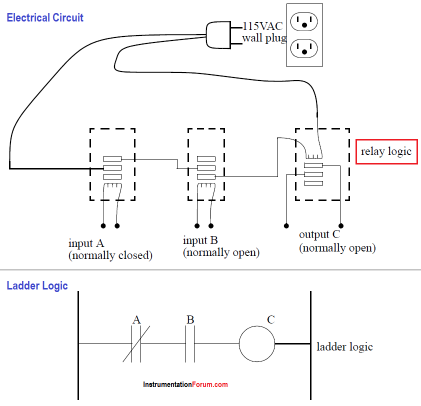

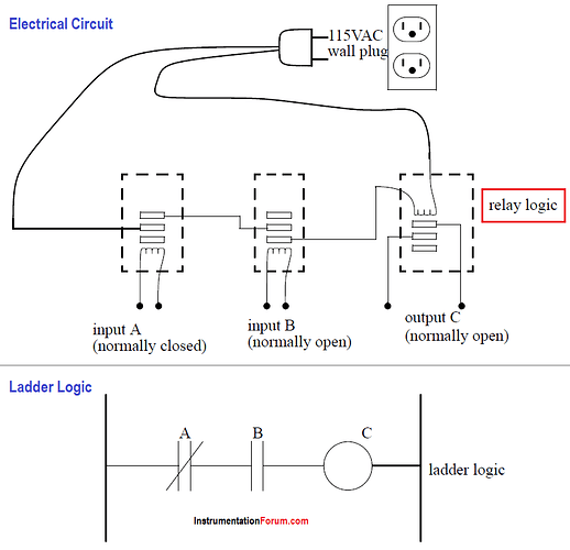

Relay Logic and Ladder Logic
Relays are used to let one power source close a switch for another (often high current) power source, while keeping them isolated.
An example of a relay in a simple control application is shown in below Figure.
In this system the first relay on the left is used as normally closed, and will allow current to flow until a voltage is applied to the input A.
The second relay is normally open and will not allow current to flow until a voltage is applied to the input B. If current is flowing through the first two relays then current will flow through the coil in the third relay, and close the switch for output C.
This circuit would normally be drawn in the ladder logic form. This can be read logically as C will be on if A is off and B is on.
