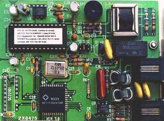

A practical illustration of resistors’ usefulness is shown in figure. It is a picture of a printed circuit board: an assembly made of sandwiched layers of insulating phenolic fiberboard and conductive copper strips, into which components may be inserted and secured by solder. The various components on this circuit board are identified by printed labels. Resistors are denoted by any label beginning with the letter “R”.
