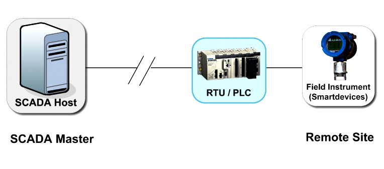

There is typically another layer of equipment between the remote sensors and instruments and the central computer. This intermediate equipment exists on the remote side and connects to the sensors and field instruments.
Sensors typically have digital or analog I/O and these signals are not in a form that can be easily communicated over long distances. The intermediate equipment is used to digitize then packetize the sensor signals so that they can be digitally transmitted via an industrial communications protocol over long distances to the central site.
Field Devices for SCADA – RTU, PLC, IEDs, and Smartdevices
Typical equipment that handles this function are PLC’s (Programmable Logic Controllers) and RTU’s (Remote Terminal Units). These devices employ de- facto standard industrial data communication protocols such as Modbus, AB-DF1, and DNP3.0 to transmit the sensor data. Typical physical interface standards are Bell 202 modem, RS-485 & RS-232.
The SCADA Host is usually an industrial PC running sophisticated SCADA MMI (Man Machine Interface) or HMI (Human Machine Interface) software. This software is used to poll the remote sites and store the collected data in its centralized SQL or Oracle database. Logic can be configured in the SCADA Host software which then monitors and controls plant or equipment. The control may be automatic, or initiated by operator commands.
Data acquisition is accomplished firstly by the RTU’s or PLC’s scanning the field inputs connected to the RTU / PLC. This data is usually collected at a polling rate configured by the operator. The polling rate is determined by the number of sites, the amount of data at each site, the maximum bandwidth of the communication channel and the minimum required display and control time.

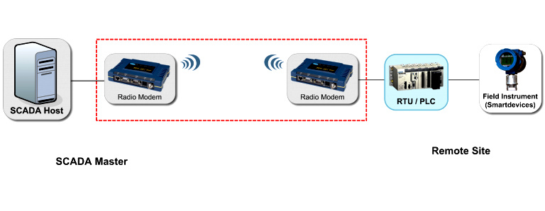

Wireless
Certain types of applications like those in Oil & Gas, Electrical & Water Utilities, Water & Wastewater and Environmental Monitoring inherently require SCADA communications because of the remoteness of the assets (i.e. Oil wells, water wells, generator stations). Furthermore, due to the remoteness many of these often require the use of wireless communications. In these cases, the traditional solution is to add a radio modem stage to the standard SCADA architecture shown above.

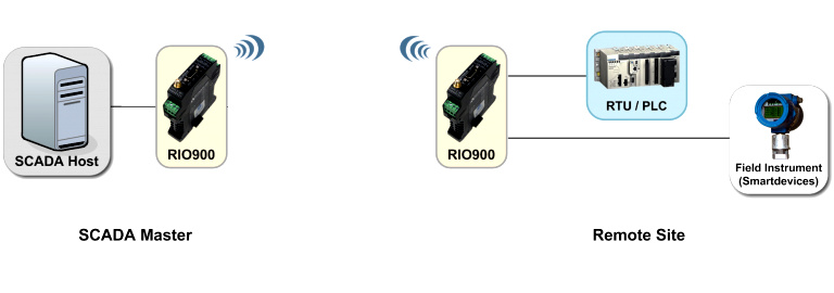

Next generation Wireless SCADA equipment such as Bentek Systems RIO900 or UNICON IP offers another level of integration by placing the wireless communications and RTU functionality together in the same package.

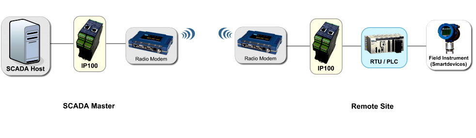

In addition to this higher level of integration, next-generation SCADA equipment such as the IP100 also support TCP/IP, UDP or other IP based communications protocols as well as strictly industrial protocols such as Modbus TCP, Modbus over TCP or Modbus over UDP all working over private radio, cellular or satellite networks. The IP100 can act as an Ethernet Serial gateway to enable older legacy serial equipment to connect to TCP/IP networks. Coupled with Host software such as NETSCADA, this enables implementation of powerful IP based SCADA networks over mixed cellular, satellite systems and land line systems.
