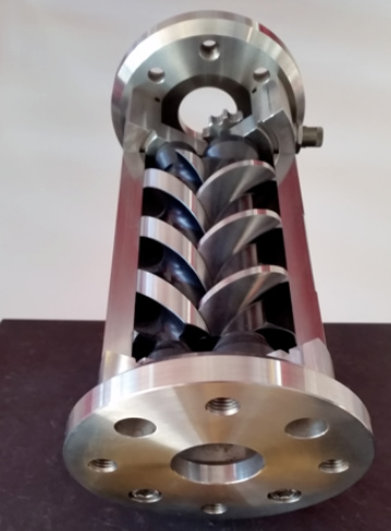

A screw flow meter is composed of a set of screws (also called spindles) which form with the internal structure of the flow meters’ casing a measurement chamber.
The screw will get into rotation thanks to the medium passing through the device, which will then be transferred by the-said screws from one end to the other end of the measuring device. For this to be done, the pressure drop is essential and seen as a “necessary evil”.
This rotation can then be recorded by a sensor which, combined with the Process Unit (a software and hardware), will be able to deliver a measurement according to the flow rate, viscosity and size of the measurement chamber.
Screw flow meter
